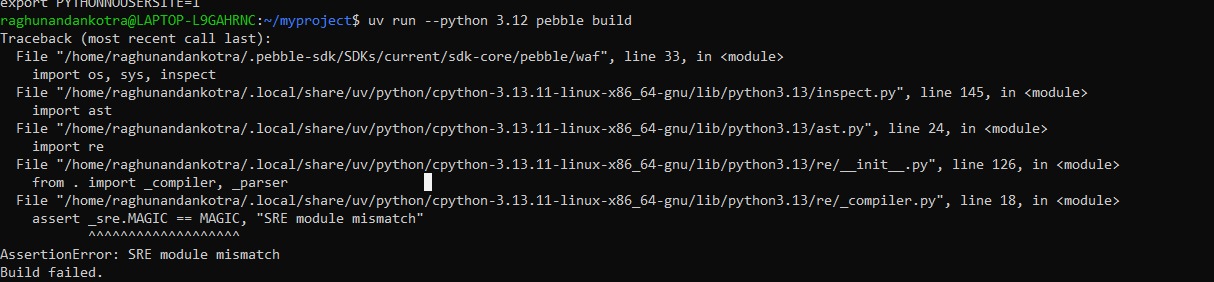

SRE module mismatch error
How do we get rid of the below error?
Hm, uv run --python 3.12 using python3.13 deps just below that is a probable issue there, does it work any better with python 3.13?
What happens if you just run pebble build instead
