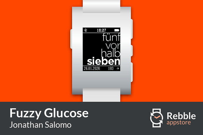

I built this recently:
It’s not pretty at all (it requires internet access, etc.), but for LibreLink it works surprisingly well. Judging by the fact that the daily user I built it for hasn’t had to call me for major changes yet, it seems to be stable enough.
Obviously, this isn’t the ideal long-term solution or something that works for everyone. I just wanted anyone searching for a solution to know that this exists.
