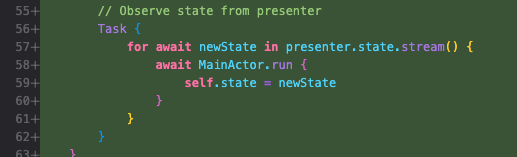

They tested using native iOS UI through SwiftUI which is very fast to write, that also looked simple, and would bring the benefit of native interactions and performance (although CMP performance is pretty good). In that part I did have some observations that can be taken with a grain of salt as that was just a phase of the POC and not what was actually delivered:
  • Detached tasks are being created that are not being destroyed, this could lead to memory leaks WatchListView.
    • Ideally you would add a mechanism to cancel this task when the view is no longer presented.
  • If we wanted to go through the native UI route I would recommend implementing design constants such as colors, spacings, and fonts.
  • We would want to transform all Kotlin Flows into asynchronous sequences like in the example above instead of using completion handlers to observe results (I saw both approaches). The current preferred architecture for swift apps is Swift Concurrency (async/await, async sequences) and not Combine or completion handlers.
  • I’m not sure what was the min target set for them but on iOS 17+ native code I would recommend using Apple’s Observation framework instead of ObservableObject
