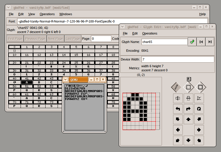

I got some good results using gbdfed. It crashed few times and I had to redraw all glyphs by hand. But it works.
